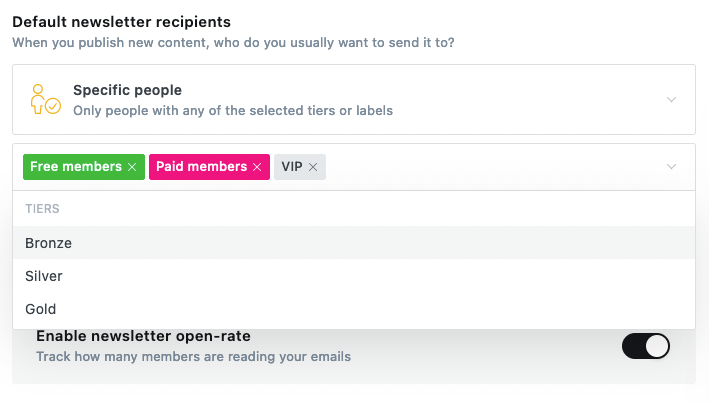

Default newsletter recipients
This setting allows you to create a segment of people to whom you send emails most often, using any combination of tiers, free or paid status, and member labels.

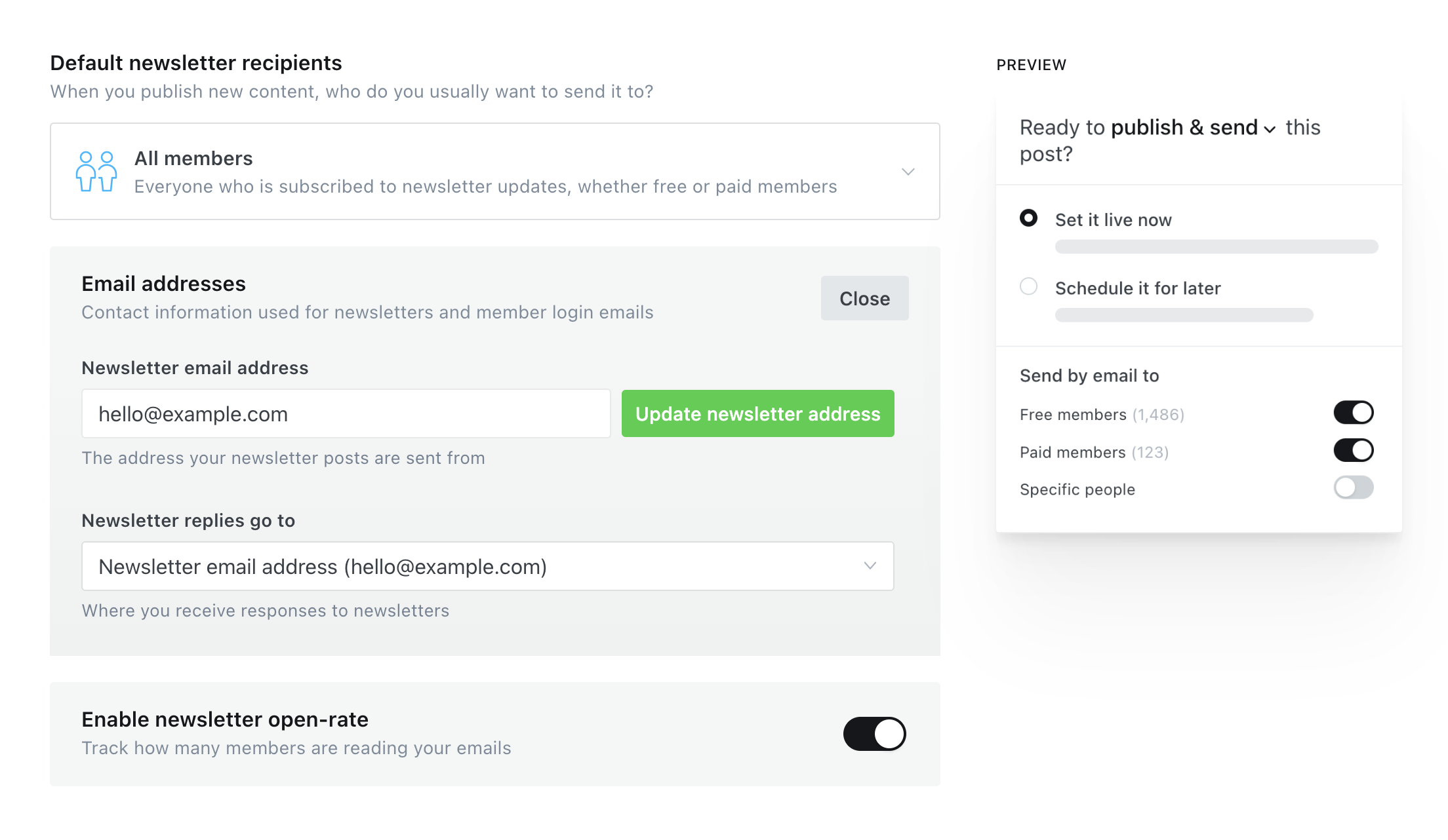

Choose a newsletter email address
Your newsletter email address is what shows up as the “from” address for your newsletters.
To change your newsletter email address, enter an email address you own and click the Update newsletter address button. Then click the confirmation link that is delivered to your inbox. If you don't click the email confirmation link, the email address will not update.
Newsletter open-rate analytics is turned on by default. If you'd prefer not to use this feature, toggle it off.
