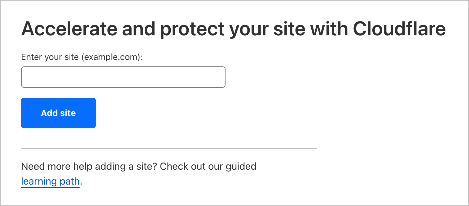

The first step for both types of configuration is to create a free Cloudflare account and follow a few steps. There are paid options available but you only need a free account to setup a custom domain with Ghost.
Enter your domain name when creating your new Cloudflare account and it will query your existing DNS records and port them over. Review these records and port any over that are required.

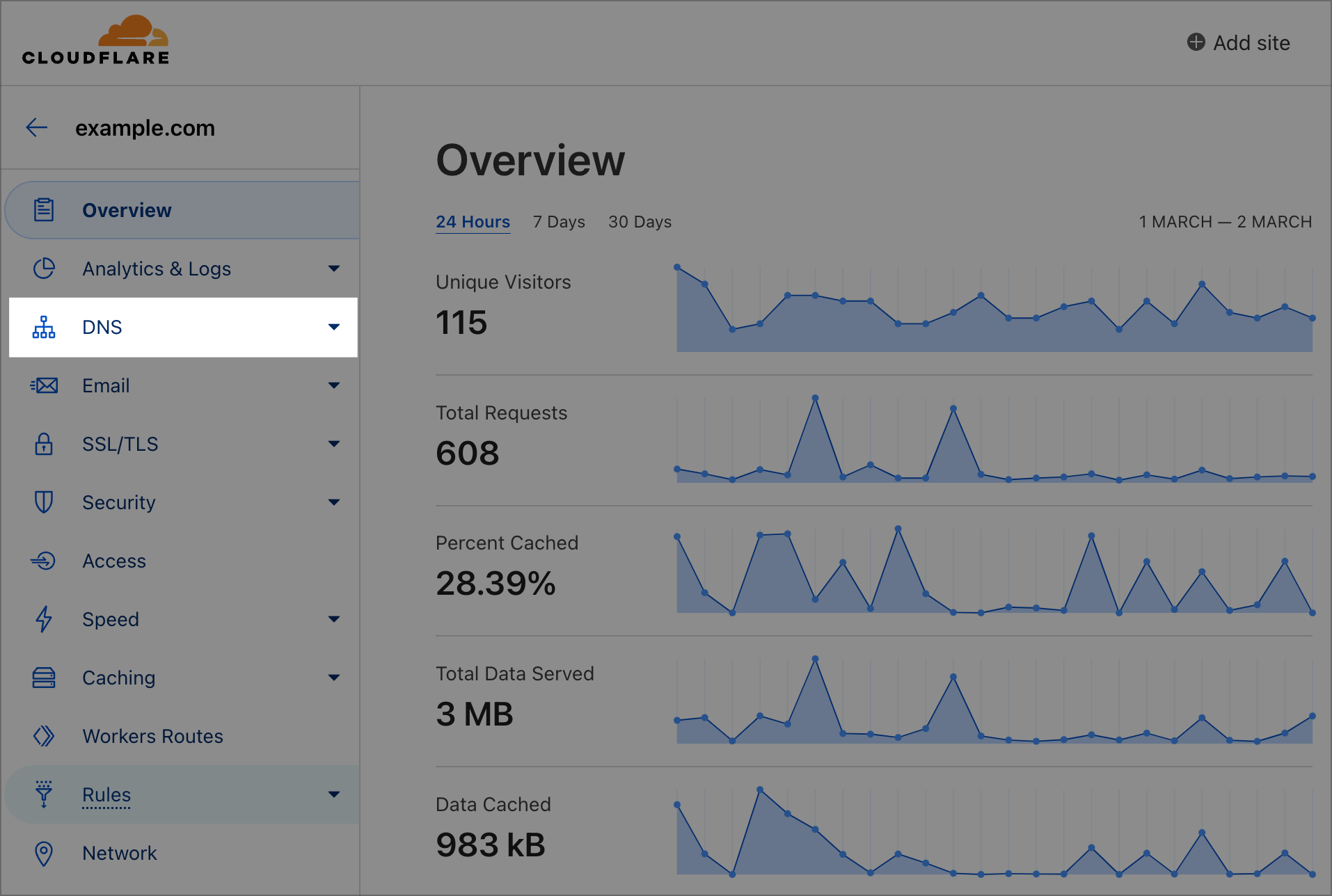

To configure your DNS records for a root domain, navigate to the DNS settings area of your Cloudflare dashboard and add a CNAME record type:

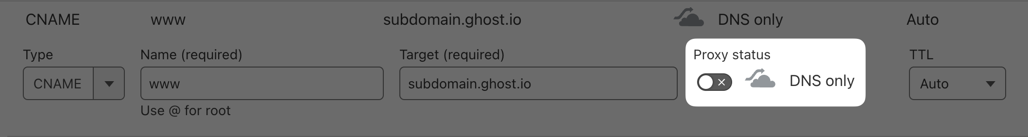

To configure your DNS records for a subdomain, navigate to the DNS settings area of your Cloudflare dashboard and add a CNAME record type:
Add CNAME
In the "Name" field, enter your desired subdomain configuration, in this example we'll use www which makes www.yourdomain.com the default custom domain.
In the IPv4 address, enter the ghost.io URL for your publication, <subdomain>.ghost.io and add your new CNAME record:
