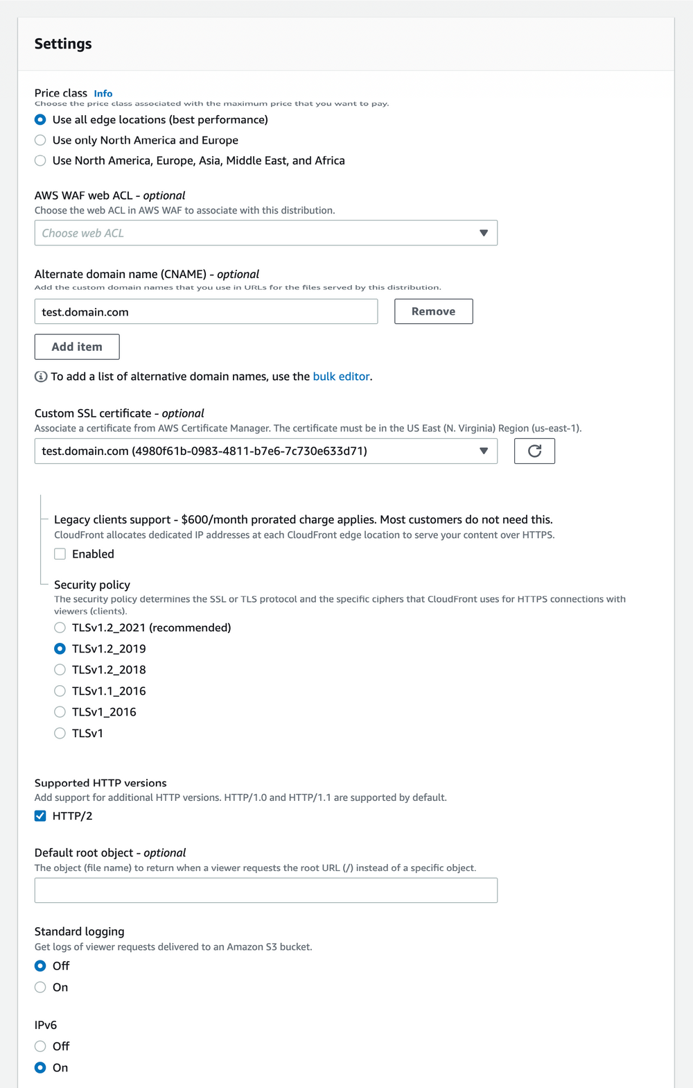

Distribution Settings
![](https://ghost.org/help/content/images/2023/04/cloudfront-distribution-settings.png)
- Alternate Domain Names must match the custom domain you want to use
- The SSL Certificate must match the desired custom domain (either exact or wildcard).

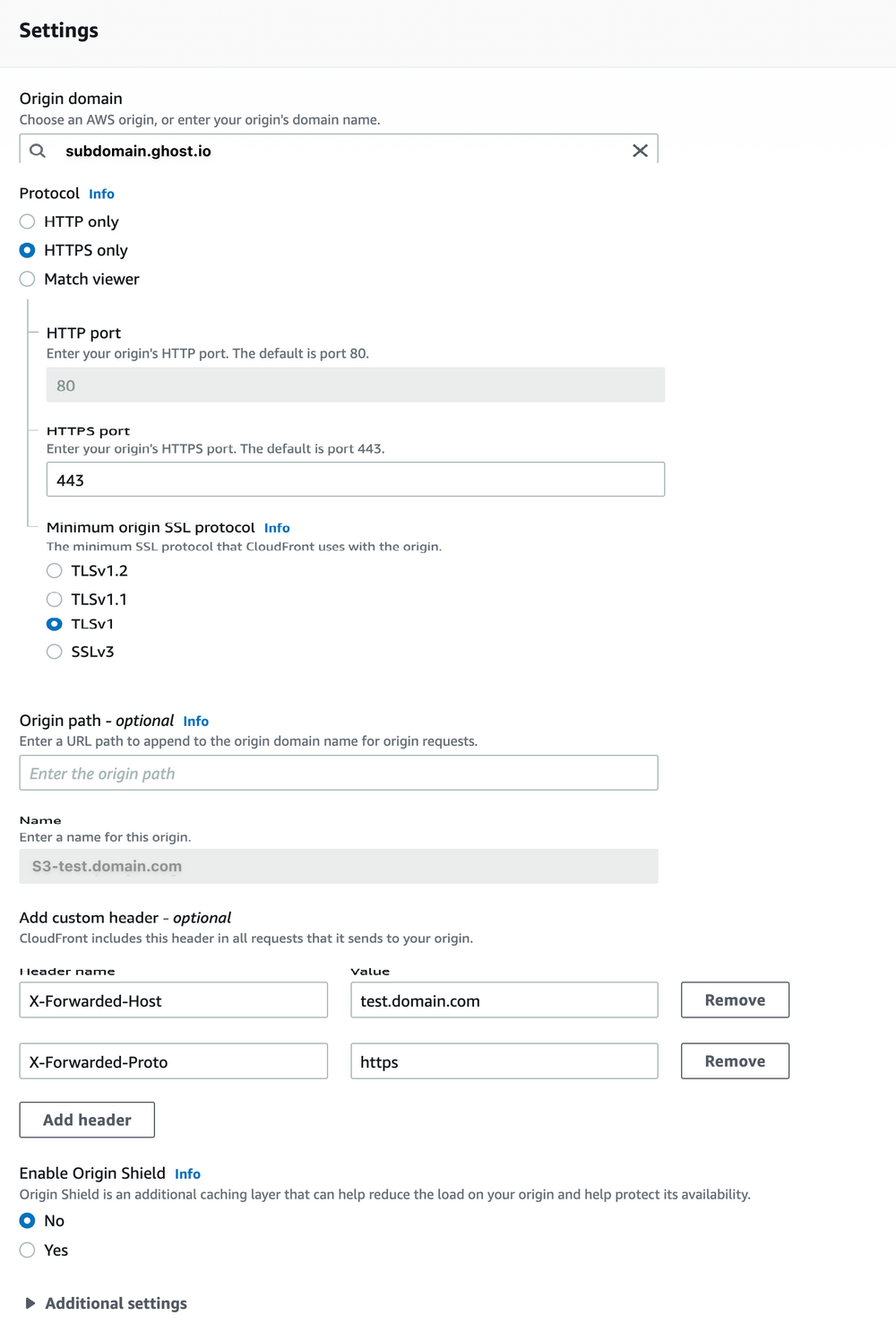

Origins & origin groups settings
![](https://ghost.org/help/content/images/2023/04/cloudfront-origin-settings-1.png)
- Origin Domain Name must match the ghost.io URL
- X-Forwarded-Host must be set to the desired custom domain
- X-Forwarded-Proto must be set to https

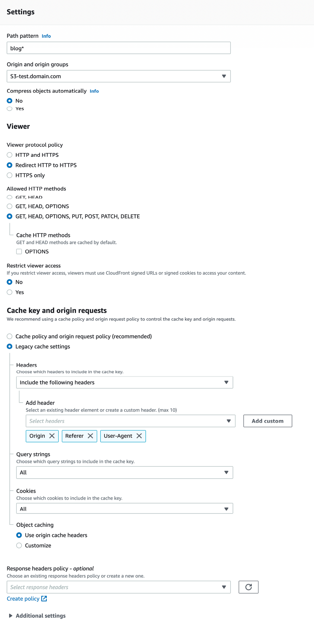

Behavior Settings
The default behavior settings for your distribution can be used, however you will need to setup a second behavior with the following settings:
![](https://ghost.org/help/content/images/2023/04/cloudfront-behaviour-settings-2.png)
- The Path Pattern field needs to be set with the desired subdirectory, e.g.
blog*
- The Viewer Protocol Policy must be set to Redirect HTTP to HTTPS
- The Origin, Referer and User-Agent headers must be whitelisted

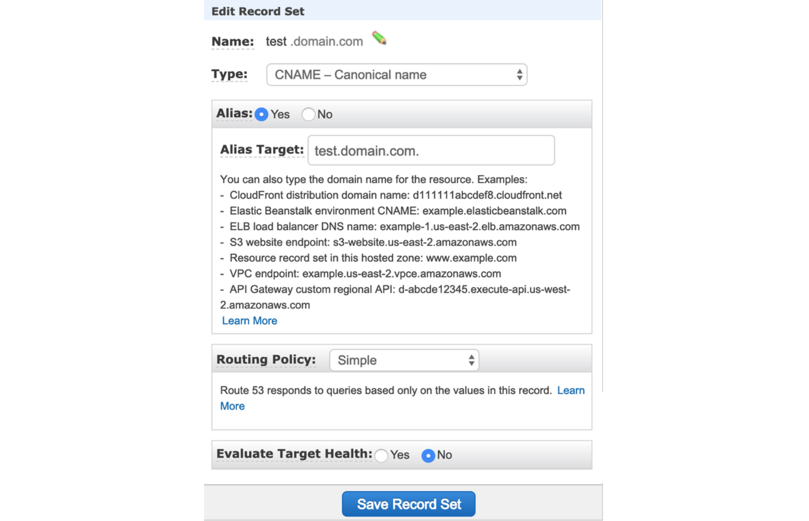

Route 53 Settings / DNS
If you are using Route 53 with your domain to manage DNS records, an alias record must be set with a target of the CloudFront Distribution.
![](https://ghost.org/help/content/images/2023/04/aws-cf-route-53-1.png)
If you are using a non-Route 53 DNS provider, you will need to create an alias record that points to your CloudFront Distribution address.
