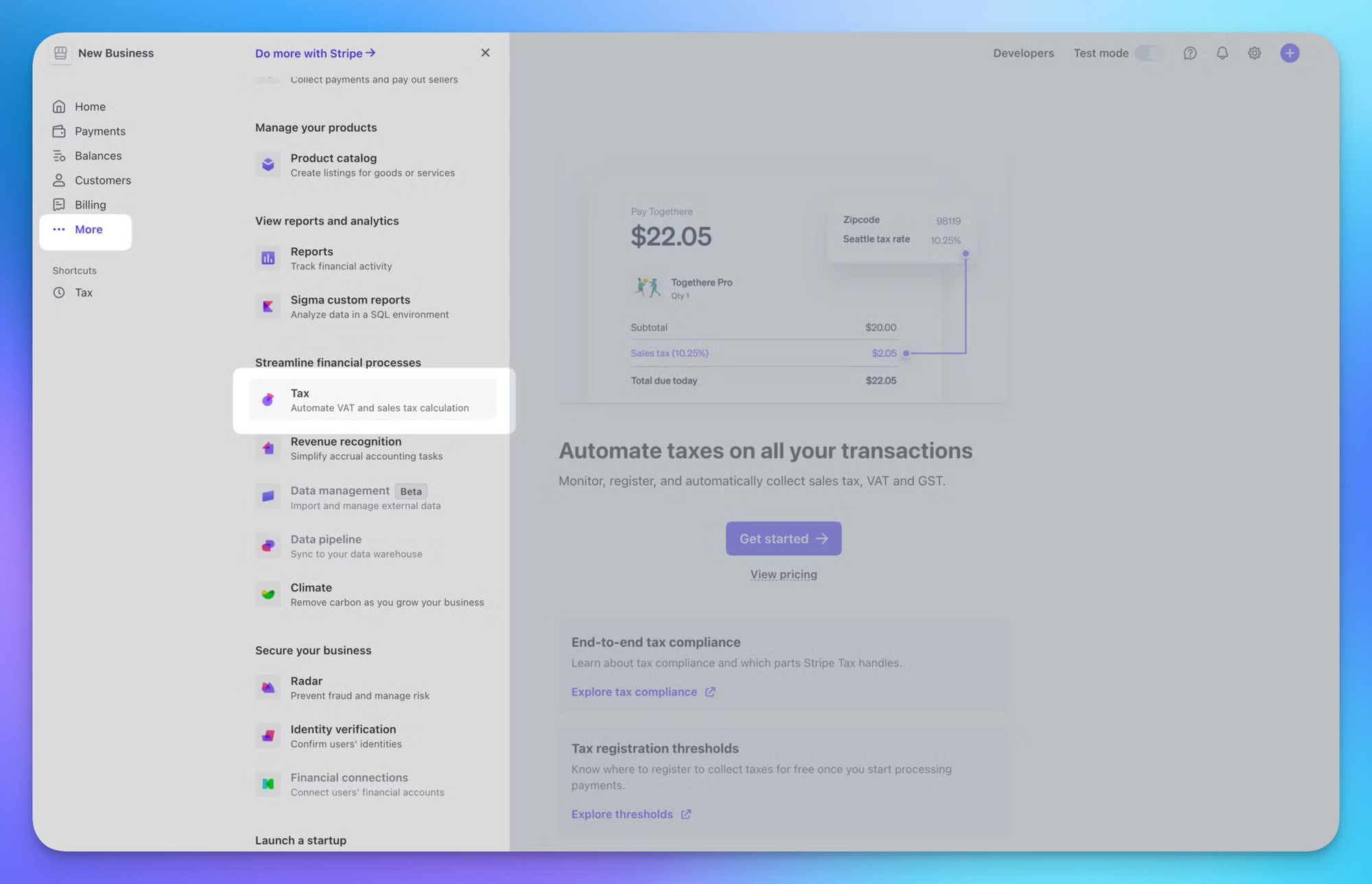

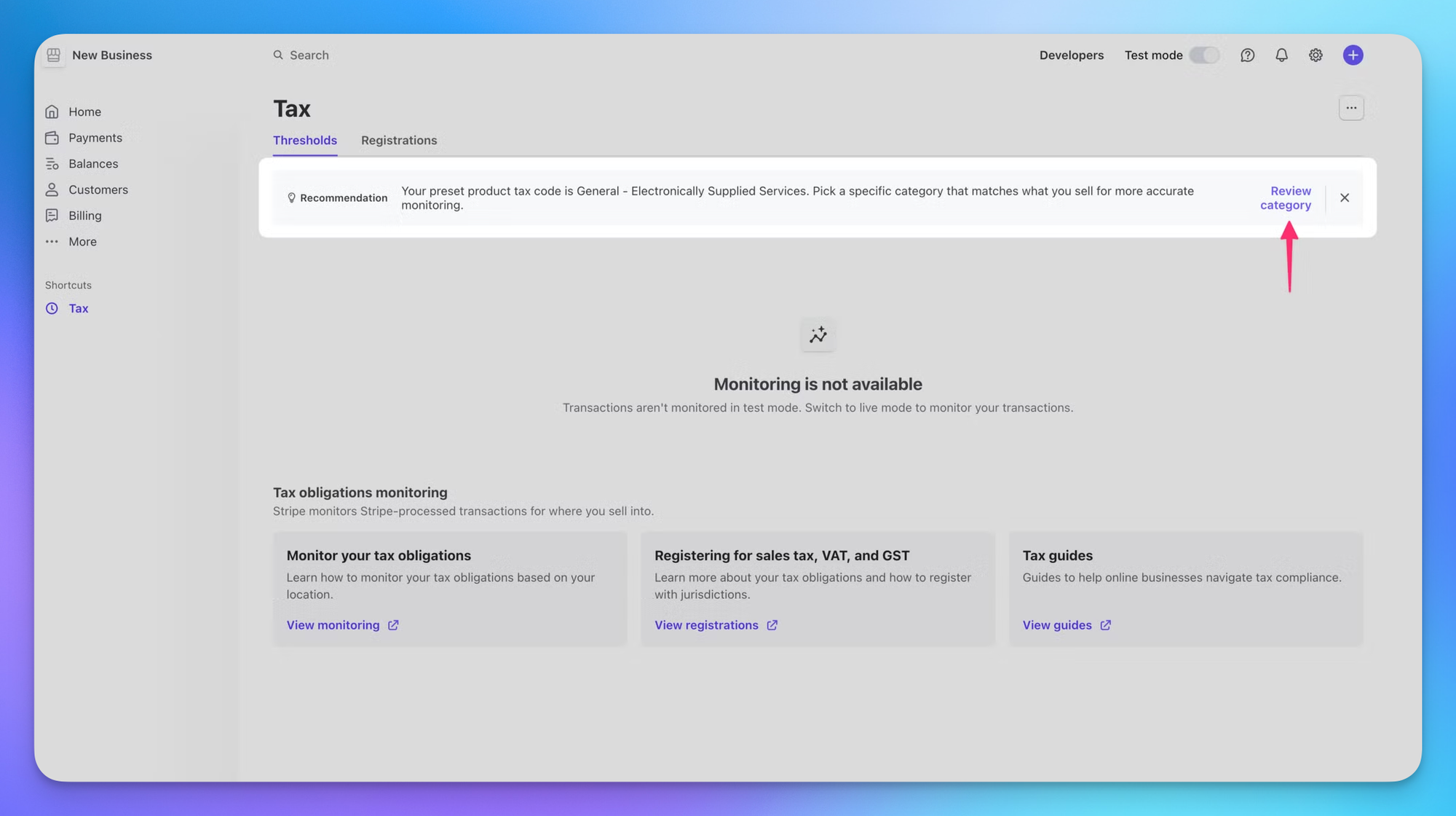

Step 1: Enable Stripe Tax
Navigate to the Tax section of the Stripe Dashboard, and click “Get started →”

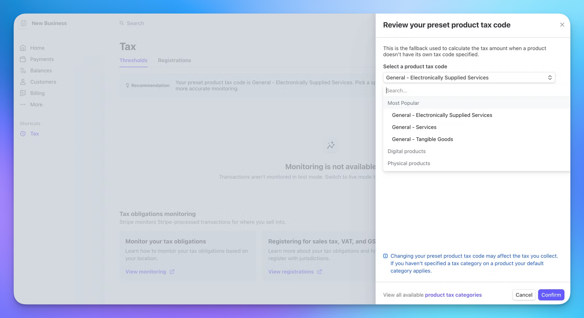

Step 2: Select a preset product tax code
Once you’ve entered the setup screen, you’ll be prompted to review your product tax code category.
From here, you can choose the product tax code that makes the most sense for your business. The default will always be set to “General - Electronically Supplied Services.”

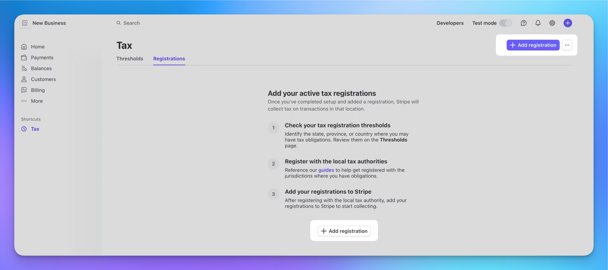

Step 3: Add a registration
If you’ve exceeded a threshold in a certain state, province, or country, you’ll need to register with the local tax authority prior to adding your registration to Stripe.

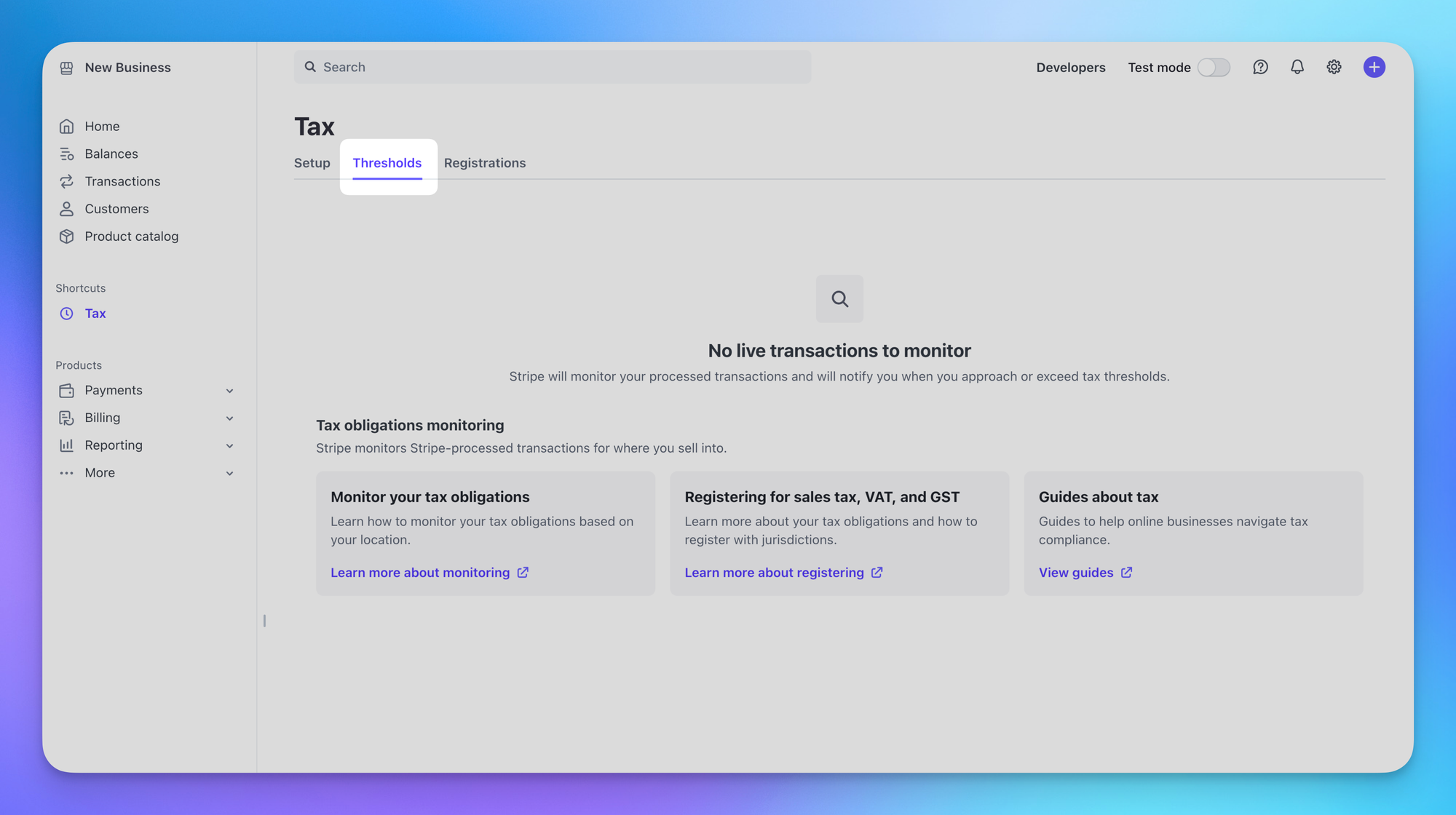

How do I know where to register?
If you’re setting this up, you may already know one or two places where this will be required, but figuring out the rest isn’t always easy. Stripe helps you identify the correct places based on your past transactions with their Thresholds tool:
Once done, you can add your registration(s) to Stripe from the Tax dashboard:

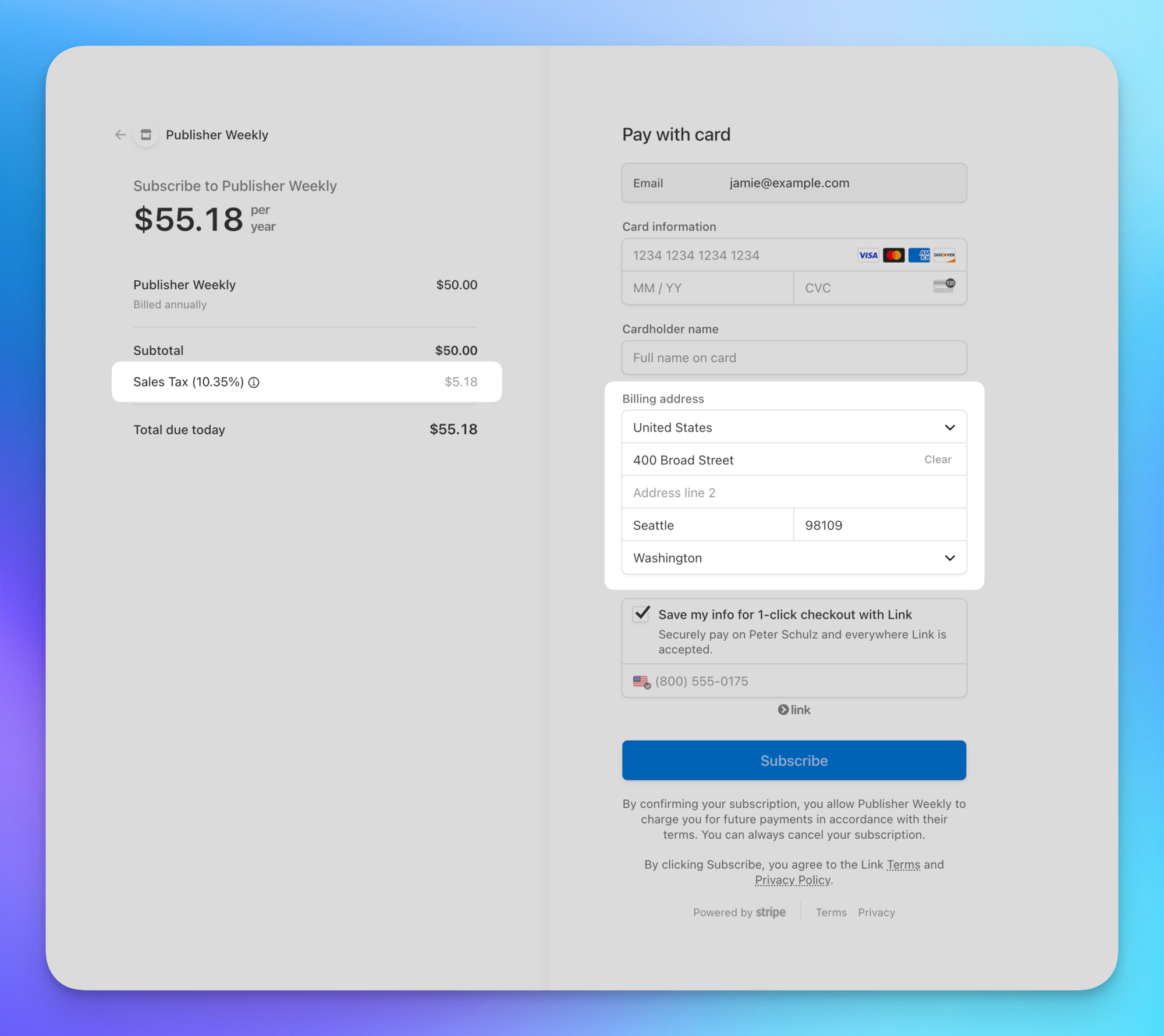

}How do I know it’s working?
Once enabled, members going through Stripe Checkout will see an additional field to enter their address. If they live in a location in which you’re registered to collect tax, it will be automatically calculated at the appropriate rate for any active tier in Ghost:

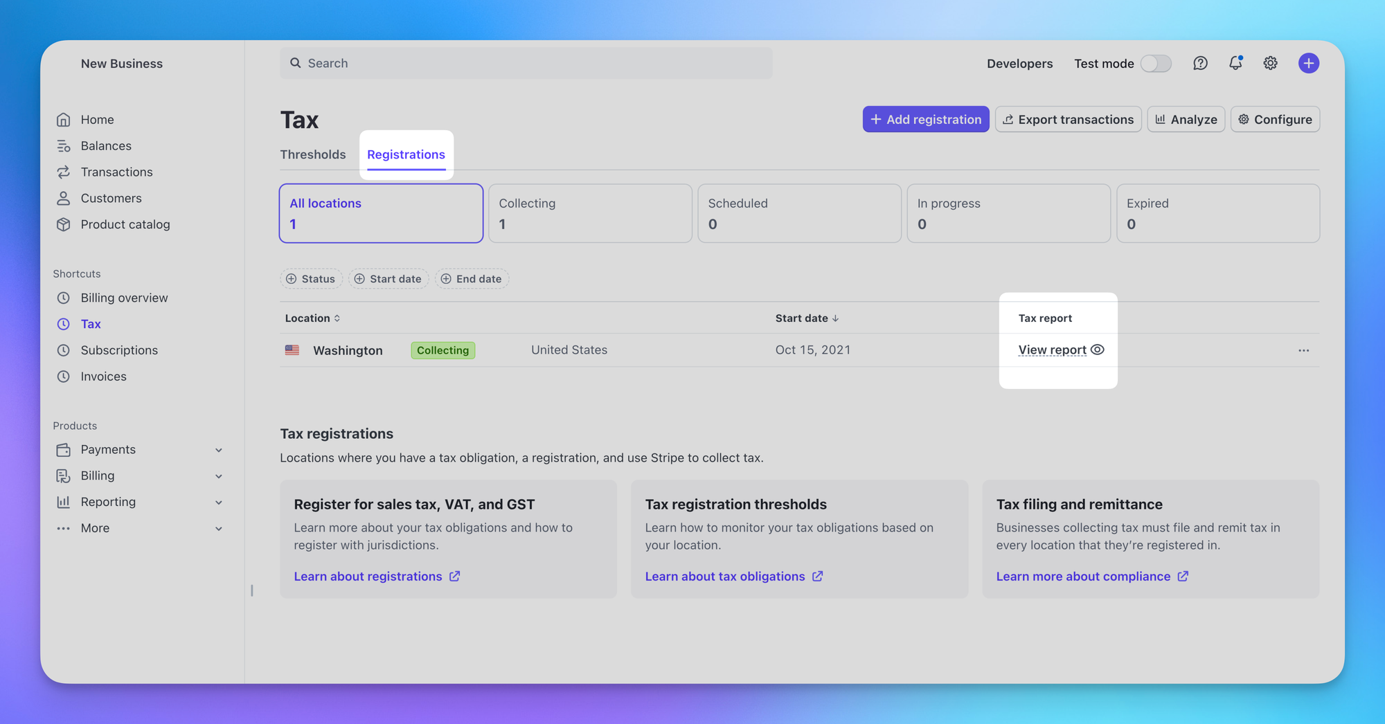

Reporting
Once the integration is up and running, you’ll be able to access reporting for each of your registered jurisdictions directly inside Stripe in the Tax section of the dashboard.
