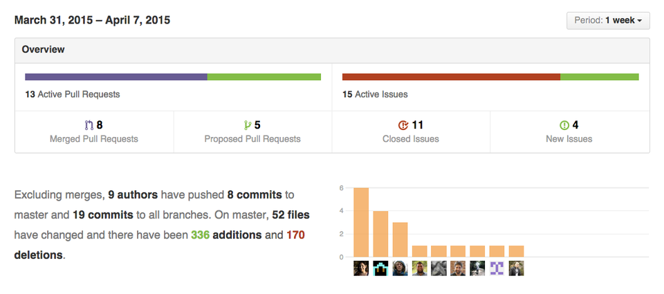

We begin with big news from team Ghost this week. As we announced on the main blog, we've launched a new public revenue dashboard as part of our big push towards being more transparent. Read the April update post for more details.
This week in Ghost land, we've seen a few interesting PRs land in master. Code injection got syntax highlighting & line numbers (#5016), and is now awaiting a last pass over the UI before having it's labs training wheels removed.
