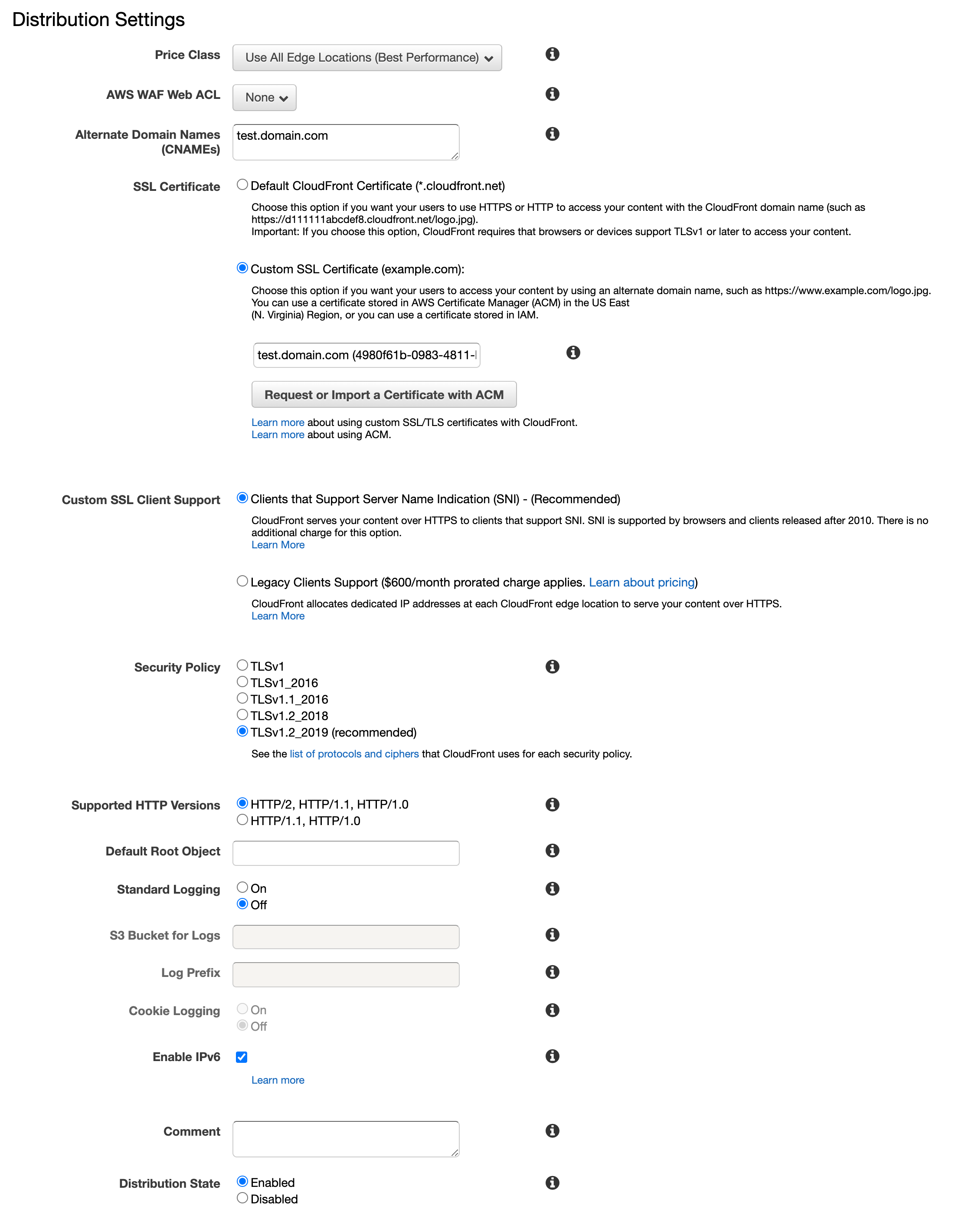

Distribution Settings
  • Alternate Domain Names must match the custom domain you want to use
  • The SSL Certificate must match the desired custom domain (either exact or wildcard).

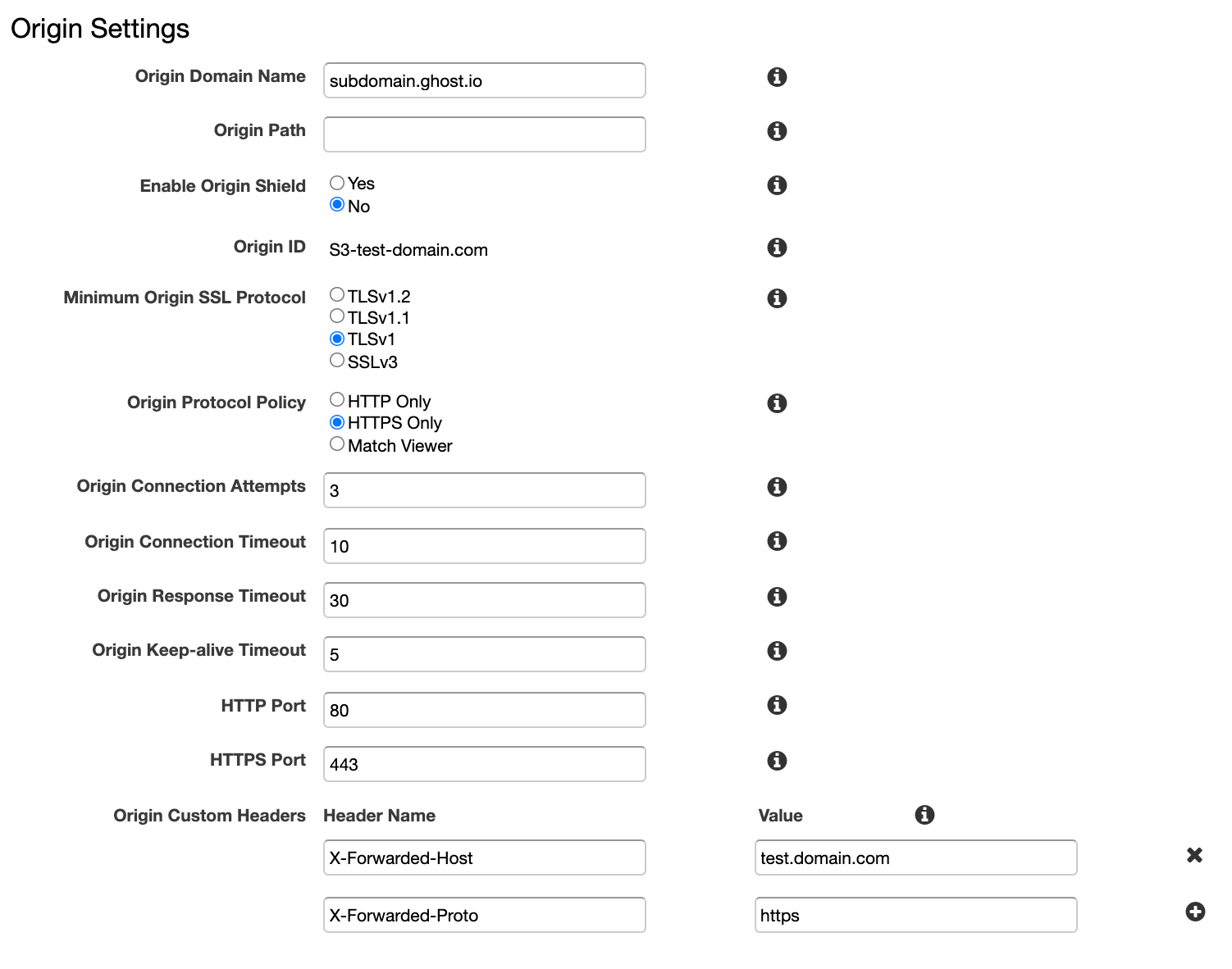

Origins & Origin Groups Settings
  • Origin Domain Name must match the ghost.io URL
  • X-Forwarded-Host must be set to the desired custom domain
  • X-Forwarded-Proto must be set to https

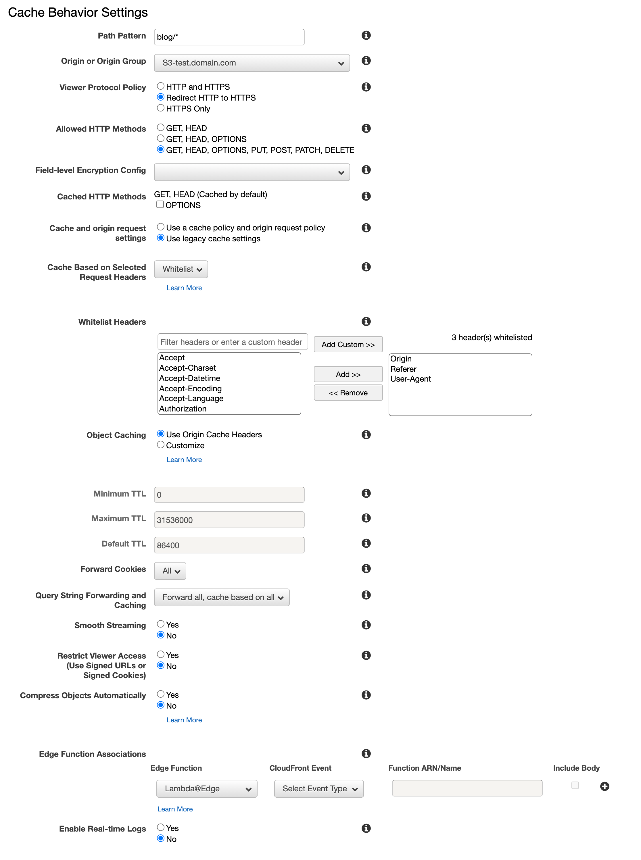

Behaviour Settings
The default behaviour settings for your distribution can be used, however you will need to setup a second behaviour with the following settings:
  • The Path Pattern field needs to be set with the desired subdirectory, e.g. blog/*
  • The Viewer Protocol Policy must be set to Redirect HTTP to HTTPS
  • The Origin, Referer and User-Agent headers must be whitelisted
